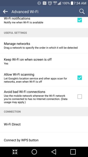

Do you have "Avoid bad WiFi connections" enabled? Maybe that's causing the issue and it's conflicting somewhere?

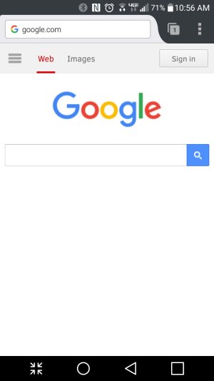

Odd. Maybe it's a Verizon thing? I just connected to WiFi here at work and it's still showing the 4G, but it's not active. Though, occasionally I'll see the up/down arrows light up, but it's rare and very quick.Screenshot_2015-10-07-10-56-23.jpg

Our Switch to Mobile Data, under Advanced Wifi, is basically the same thing. Says, Switch automatically to mobile data when Internet unavailable via Wi-Fi. (AT&T)
I saw that... But I'm gunshy to change anything right now, as I haven't had an issue in two days... Do you have that checked?
Sent from my LG-H810 using Tapatalk
No, I don't. Only have allow wifi scanning checked. Oh and Wifi notification is checked.
