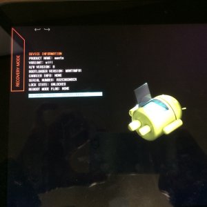

At this point my tablet is stuck at what I believe is called the fastboot screen.
(I'd post a picture, but I am getting errors posting this message which I think may be related to the pic. If I can I will post the pic in another message).

I have tried running flash-all a few times after restarting the tablet with the same result each time. I have also tried from the tablet using the volume rocker buttons to change the words there from "Start" to "Recovery Mode", then either leaving it that way or pressing the power button to select the option that was selected. When doing that, it just restarts the tablet so I am assuming that is not the correct thing to do. I read in some other article that is how to get into Recovery Mode, but it may have been for an older firmware version.
Anyway, I'm stuck at this point with a bricked tablet. Any assistance would be very much appreciated.

Looks like you didn't get the new files written to your device. Try Wug's NRT . It allows you to install from a soft-brick or bootloop. Technically, you are at bootloader so you should be able to manually fastboot flash the images from CMD prompt. This requires downloading and extracting files to your ADB folder.
You are at the bootloader/fastboot screen. It requires a button combo (pwr&vol+, I think) to get to recovery.
(while holding down the Power button, press the Volume Up button.
Use the volume buttons to scroll to "Wipe data/factory reset," then press the Power button to select it.
Scroll down to "Yes - erase all user data," then press the Power button to select it.
Note: If your tablet becomes unresponsive at any point during these steps, you can restart it by holding down the Power button for several seconds.)
The button thing can be tricky--exactly the same time and hold for a few seconds then release. I generally run rooted with custom recovery so I forget exactly how it works. This will only work if there's still a system on your tablet. With Wug's, it's done for you. This requires a Window OS.

Yeah. I did post a message there, but no one responded. Fortunately I got it figured out though. I followed the manual flashing instructions using a Linux box. That worked great. I'm guessing my Windows box had a driver issue or something.
Thanks for the follow up.
I saw no response so I made reference to it. Glad you got it worked out. Wug said the messages were indicative of bad USB connection.
