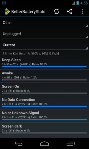

OK. I can see about 3% drop for 6Hrs. Gives us 12% per 24Hrs.
Very god result, but not 5% per day. :) Still very good.
BTW, wasn't able to post a screen shot from N4. Something's wrong with app?
Oh, finally posted it.
This is mine battery consumption.
Cell standby eats good part of it when phone is very lightly used.
But I think this is still good optimization of battery use.

Yeah, and you only have two bars reception. Keep in mind, low cell signal *kills* battery. How is your signal strength throughout the day?

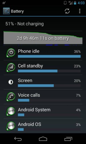

Was it Airplane mode? O_o VERY good standby results. Could you also post your standard battery screen (from settings)?
No, my mobile network was on (no data though). I use DeepSleepBatterySaver, maybe it helps?
