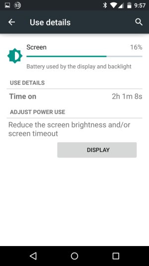

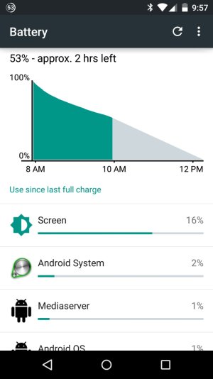

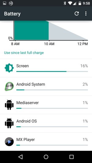

So I replaced my battery this morning, and my screen on time about quadroupled lol.
Before I was getting about one hour of screen on time. On airplane mode and doing nothing but leaving the screen on, I would get roughly two hours of screen on time. Now after replacing the battery, I just played a movie for two hours and I still had 53% battery life left, so theoretically I should be getting about four hours of screen on time now. :D
Replacing the battery from start to finish took me about one hour. The most difficult part was removing the back cover from the N5. I have to say, the fit and finish of the Nexus 5 is remarkable - too remarkable in fact, because it was extremely difficult to take apart lol. But once the back cover is off, the rest of the install was pretty easy. One thing I'd like to add though, like others have mentioned, is when you're taking off the back cover, be sure to use a plastic spudger instead of a metal one, otherwise you WILL scratch your phone.
The battery was $11 and I needed about $19 worth of tools to do it. Definitely the best $30 I ever spent. (I'd still rather get a phone with a removable back cover and removable battery though, just to avoid the trouble in the future).
