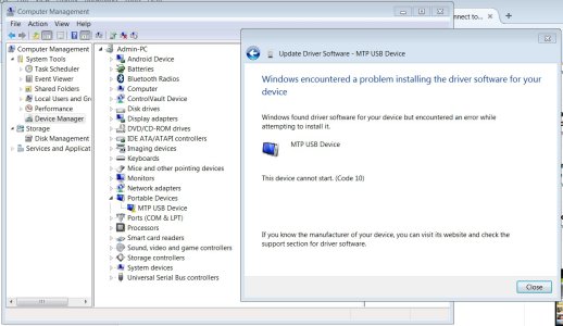

Apologies for bringing up this post, but I am having the same issue getting file access in Windows explorer with my Nexus 4...could only see it with PTP Camera mode, not MTP.
Trying your instructions above, I get this code 10 error...any suggestions?
Are you able to right-click on "MTP USB Device" and Remove Device? Then unplug the phone from the computer, wait a few seconds, then plug it back in, and see if the Plug & Play feature automatically finds the right driver.
