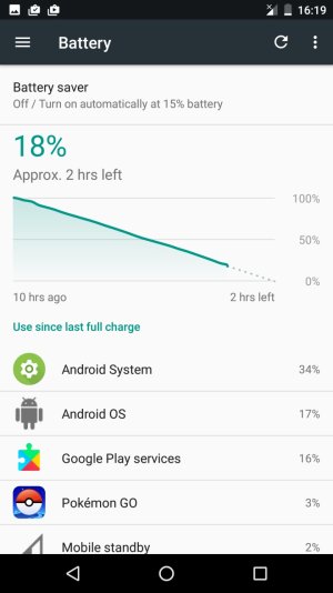

I just got a new Nexus 5x. I am attaching a screenshot of my battery drain overnight. What's going on? Is this normal? What can I do to prevent this?

Android 7 has a serious battery bug. Both the 6P and the 5X seem to be affected, but not everyone with those phones is experiencing it.
Look at this screenshot of my 5X:

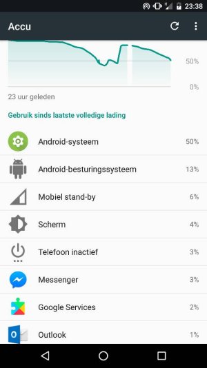

Does anybody know whether installing nougat from factory reset vs upgrading is a factor? I am experiencing this problem and I just upgraded from Android 6. I'm thinking I should probably try a factory reset, but I'd be pretty annoyed if I do that and it doesn't help.
I've done a factory reset, a complete wipe and a fresh install, nothing helps. I'm going to wipe and flash fresh with the October image just for my own sanity at this point. VERY frustrating as i'm sure you are aware.
I went so far as to flash Marshmallow to get the battery back.
I just did a wipe and re-flashed nougat yesterday, same freaking thing. I'm back on MM and that's where I'm going to stay until this issue is fixed. I flashed nougat last week and didn't install a single app, other than stock, and left the phone for 12 hours, didn't even touch it, and it lost over 60% of the battery to Android OS and Android ssystem.
If it were just a bad battery, the battery drain would be the same with Android 6 & 7, it's not. My battery lasts 40ish hours on Android 6, MM, and not even 20 hours on Android 7, Nougat.
