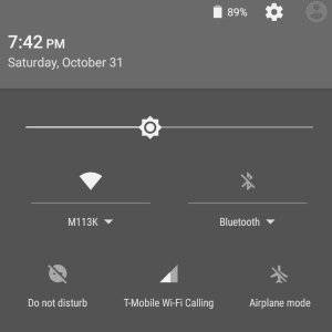

if WiFi Calling message disappears, then I have to reboot and then it works again...
Have you actually made a call on WiFi yet?
Some of the Quick Settings icons only appear if you use them....
Oh, it's in the Quick Settings screen.
So how long does it take to disappear?
