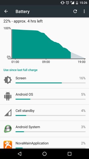

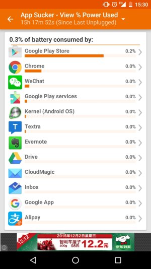

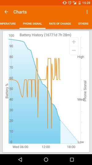

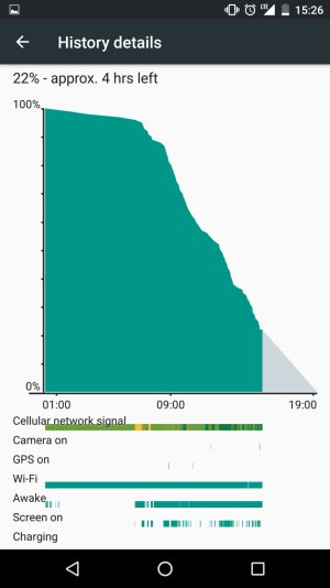

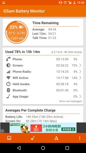

Hi all, sorry to bother you guys but I have a frustrating problem. I got my nexus 6p recently and installed all my old apps from my HTC one (had no battery issues).
Ive had it for 2 days and battery life was around 8 9 hours with normal use so I knew something was off. I checked battery and noticed I might have a wake lock problem. After doing research I don't know how to tackle it without rooting my phone. Please see screenshots!
I literally am so confused since NO Apps are taking up battery...And I have even tried putting the phone on airplane mode to see if it's the phone signal but it's still "awake" even on airplane mode! Please help :(

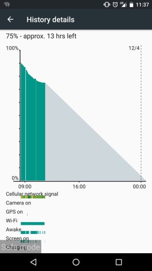

If you have rebooted your phone, let it sit there for like an hour without touching a single thing and still seeing that it's awake with no screen on time, then that's very odd. Next thing I would do is boot into safe mode by holding down the power button and then holding down the on screen power off button. Booting into safe mode will disable all third party apps and leave you with a completely stock device with only system apps. If after booting into safe mode and still having the same issue, then there's more than likely a bigger issue than just a rogue app.
that's actually an amazing idea. I've already tried letting it sit for hours without touching it and the screen on bar is empty but the awake bar is SOLID... (lol)
I am not rebooting into safe mode and going to let it sit. Thank you!

Good news!
So you guys can see all the solid "awake" times is the problem I am referring you. Then the wakelock problem seems to be much better towards the end in safe mode. So do you guys suggest I factory reset it and install apps one at a time?
