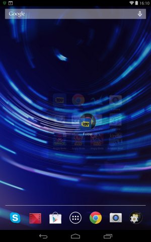

Has anyone else had an issue with folders where the folder contents and border stay transparent after you open them? I have attached an image of what I'm talking about. The icons still work in this state with no issue other than the transparency. It seems to be a completely random occurrence too, but I have yet to find a folder on my system that is immune to it. I have atepted to delete and recreate folders. I have also tried to create new folders from scratch and all will get this every once in a while.

Same problem. If you touch somewhere else and then select the folder again it looks normal. Still quite annoying.

Yes, it is quite annoying and it seems to be happening more often for me now. I have found that you can still select the icons in the folder even though they are hard to see.

Go to Settings - apps - all apps - Trebuchet (or what ever launcher is giving you the problem) and clear data. you will have to redo the folders but this solved the problem for me. I triggered this issue by lowering the window animation from 1.0 to 0.5. Working on a samsung S4
