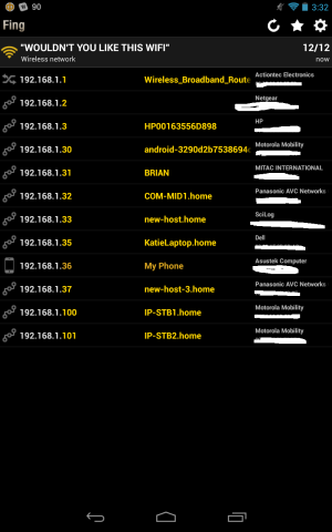

Here's a pic of my setup via "Fing". I plan on DD-WRT'ing (rooting) the "MAT2G" and "MAT3G" so I can use them as repeaters and have it all seen as one by the wifi gods.....

Oh that was fun looking at the "Fing" stuff. I ran "Fing" and attached my screenshot to this reply. What's interesting (and not sure if this matters) but my netgear 3700 which I have assigned to the .2 address- the name isn't showing.

Cool, but you should probably edit out the mac addresses ( the 00:00:00:00:00)...
It's not. You can edit and add names and icons by long tapping the ip's...
You can also test them, pings n what not by quick tapping....

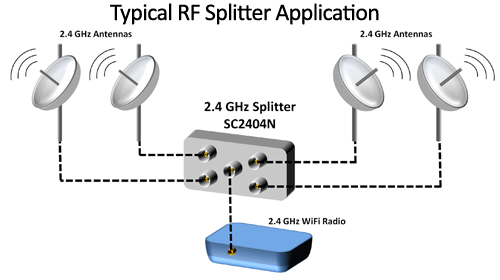

I'm not against rooting, but for some reason I've been trying to avoid that with the nexus. After reading and then reading some more, I've come to the conclusion that the only real fix is to use a single router and more antenna/s. Found one site that sells all the goodies (I'm sure there are more), and then like I always do, took their descriptions and model numbers n such to ebay. Found amps and 12 to 15 dbi omni directional antennas and even splitter/combiners (antennas everywhere from the same router), and could probably do what I need for around $200 bucks. Of course what I want and what I need are two different things, and what I want would be a tad more....

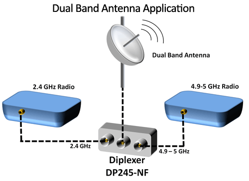

What are RF Diplexers? An RF Diplexer is a device that combines two signals onto a single transmission line. In general the two signals operate at different frequencies. L-com?s Diplexers are designed to split 2.4 GHz and 5 GHz from a single radio feed to separate 2.4 GHz and 5 GHz antennas. Many dual-band 802.11a/b/g radios share a single antenna. These devices split these signals so that two separate 2.4 GHz and 5 GHz antennas can be used to improve performance. In addition, L-com Diplexers can also be used to combine 2.4 GHz or 5 GHz signals onto a single cable.
