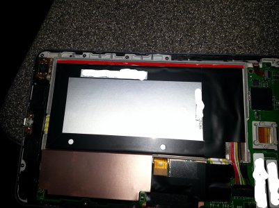

just an fyi for anyone who's having these kinds of issues, wiredfellow in this thread suggested taking a look under the back cover at the battery connection.
I did this on mine and found that the battery compartment is just a touch bigger than the battery and any sudden jolt to one side could potentially pull the connector out slightly (you can see the extra space in the picture I took below, highlighted red). I put some sugru in the extra space to prevent the battery from moving about and haven't had any issues thus far. (the back cover comes right off just using your nails all the way around, or a spudger of course)
xterror, I bet that's what happened to yours, everyone else, go check!

Perfect fix. My just opened nexus7 had the no charging fault.
On opening the device, the battery connector was dislodged.
All now working.
This is a serious design fault by asus.

I'm not sure that's a foolproof test (backlight on) because the battery isn't completely disconnected with this fault mode, it's just slightly dislodged. My 7's backlight would very clearly be on when I held the power button down with odd screen behavior (slight digital 'snow').
