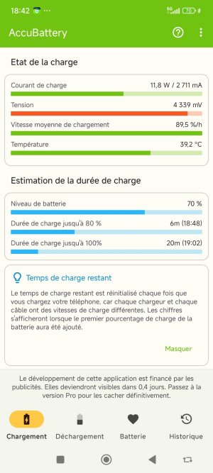

Hello, I received my xiaomi 12 a short time ago.
1st problem the charger provided is not a 67w but 22.5 (I ordered an official 67w)
Despite this, the phone only charges at 6w maximum.
And in the battery options I don't have the fast charge setting, which probably doesn't help.
Is this a hyperos bug or something else?
Thanks
Welcome to Android Central forums. With fast charging all companies put out their highest rating for what the device can accept failing to mention that charging happens in tiers. What you will see is zero to 50% times or 10% to 50% times which is usually something silly like 0 to 50% in 10 minutes, I'm just using numbers don't quote me on the actual percentage. Then what they don't tell you is that after 50% that number goes down. The next 30% might take 15 or 20 minutes, so now we're at 80% and that last 20% might take 25 to 30 minutes. So it fully charges in under an hour but looking at the times it takes way longer for the last 20 percent than it did for the first 50%. They have to throttle the charge towards the end to avoid damaging the battery. In your screenshot you're at 85% so only 15 percent left before full which is the slowest time because they are trying not to damage the battery. If you want to see high wattage out put/input drain the battery to 10 - 15% and connect it. Then you will see the spike and as you watch it you'll see the wattage drop as it nears full.

Thanks, but No it's same things when I have 5% of battery, it's always slow.
I don't have the option in setting for quick charge, I have search on the net and normally this option is here (on my screen)

For the moment I use the cable and charger sell with the phone, but I think the seller have replaced them, it's not a 67w but 22.5w
Answer tomorrow when I have the new and original

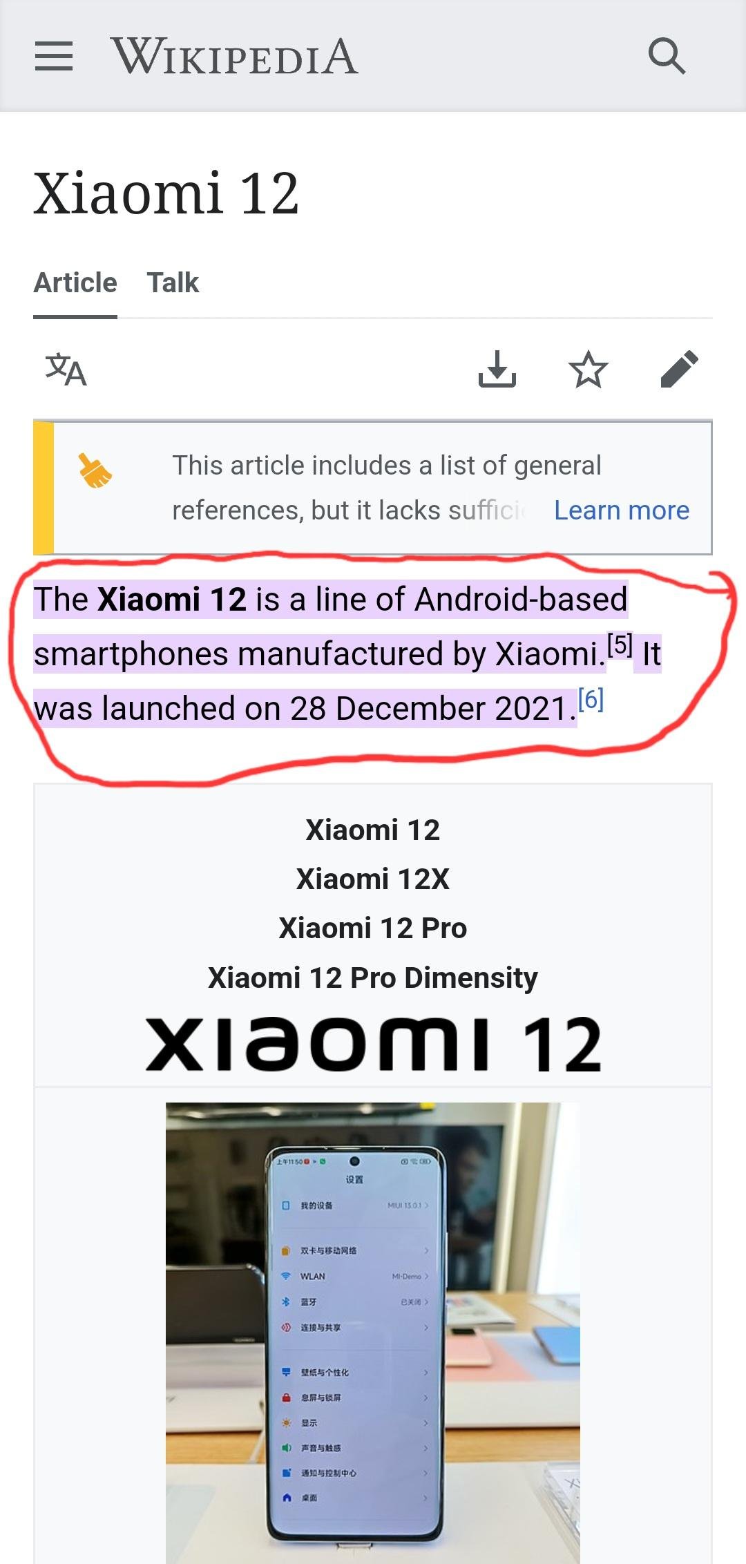

That device is almost 3 years old , possibly battery degrading , try closing all background apps see if charging speed picks up and also try safe mode.
Welcome to AC!
Thanks. On the package it's write 2024 I think is not old, and accuratery say battery is fine

This is what it says on Google

And with new official charger I have 12w
If I want reset, the best is by settings or wipe data in stock recovery ?
I have make a antutu and I have 1105600 so it's good, the only problem who stay it's the charge who is slow
