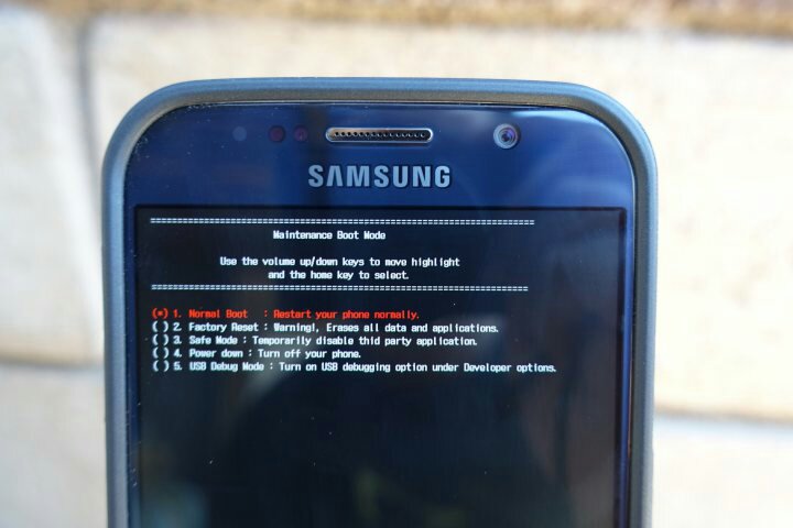

I cant seem to access this. When I press and hold the volume up, power, and home buttons at the same time and boot, it brings me to a maintenance menu and wipe cache partition is not an option. What am I doing wrong? I even watched a couple of videos but the Android guy is not popping up on mine.
How long are you leaving the phone off before trying? Leave it off for at last minute next time. It seems like you're doing it right so other than it might not be powered down totally I'm not sure what else to suggest.
I just shut my off my phone for about 5 minutes. Then I held the volume up, home, and power buttons and the device powered on. The initial galaxy s7 screen comes up and then turns black. A few seconds later, the maintenance menu comes up with options like normal boot, factory reset, etc. Ive tried releasing the buttons sooner but the phone just boots as normal. I can't understand what I would be doing wrong.

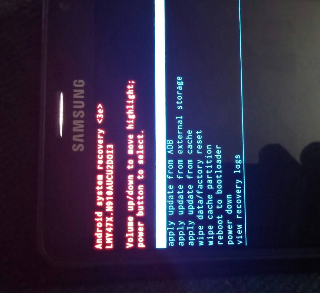

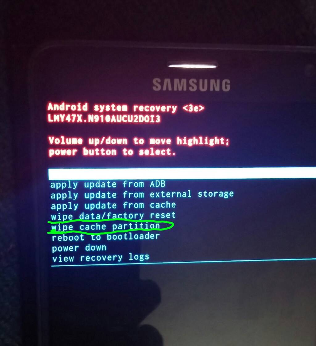

Does it look similar to this when the maintenance screen is there?
If so that's the menu you're looking for
//uploads.tapatalk-cdn.com/20160506/677f9d9245d67e613110dddcff0005b4.jpg
//uploads.tapatalk-cdn.com/20160506/77273ba6328bee3655c19ebb171efc2d.jpg
It looks similar but does not have these options listed. At the top in the picture it says Android data recovery. On mine it says android maintenance menu and I have different options listed and wipe cache partition is not one of them.

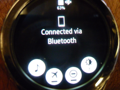

On the Gear device, there is a Do Not Disturb function that may have been turned on. Mine was and I stopped receiving notifications for 2 weeks until I found it on my Gear. To locate it, when your watch is visible, pull down/drag down o the screen from the top of the watch bezel and touch this icon to turn it on/off
