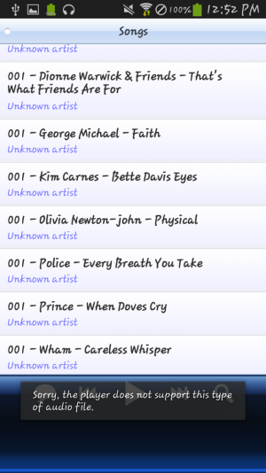

I cannot seem to get it to permanently store anything on the SD card. It may store copied files for a day, two days, or a mere hour before relinquishing them, and then no more. By this I mean that my music player will prompt me that that it is sorry, but the player cannot recognize the file - like a bad break-up speech or something. (see attached) I half expect a secondary prompt to appear stating "It's not you - it's me". Sometimes it will play the first 2 seconds of a song before skipping on to the next track, sometimes it will sound like a badly damaged CD, and skip the whole way through a song.

Or while you are at it try using a stock media player or different media player all together. What is the one you are using if you dont mind me asking.
as far as SD cards are concerned we will need to know things like sd card brand and model name. Read/write speeds are important, cheapo cards are know to have issues and unfortunately not all cards are created equal. But if you have errors with different media file types it leads me to believe its an sd card error regardless of whether its a new card or not, not the phone. Try this. A picture or song that you normally have problems with, try saving to internal phone memory. If it can be viewed or listened to then it is most definitely your craptastic sd card. If not then it is your phone or files errors.
