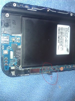

This seems to be an upcoming problem with these phones. I posted a thread the other day about my problem and then started finding all these new ones: http://forums.androidcentral.com/samsung-galaxy-note-2/268354-charging-problems-acting-flaky-need-help.html. I took mine apart and actually found cable unplugged from the circuit board. You can see it on the bottom of the photo about in the middle. I found a site online that sells the USB charging board for about $12 for my L900 version. Some of the other models sold for about $10. I'm going to buy and replace the board and see if that solves the problem.
I plugged it back in and reassembled everything and the battery went from a reading of 24% to 75% and it continued to charge up to 100%. It does still seem to go in and out of the charge cycle though.
