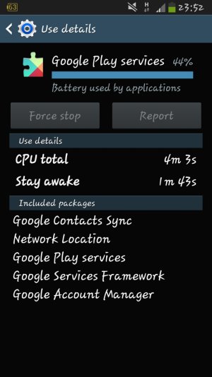

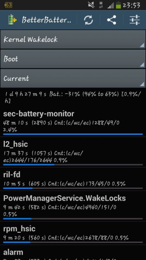

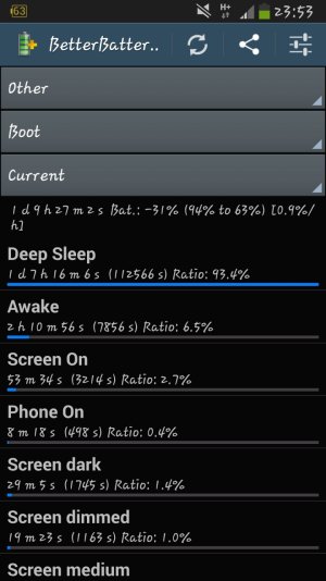

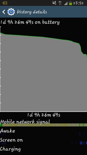

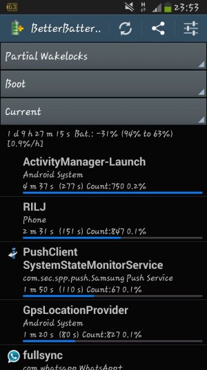

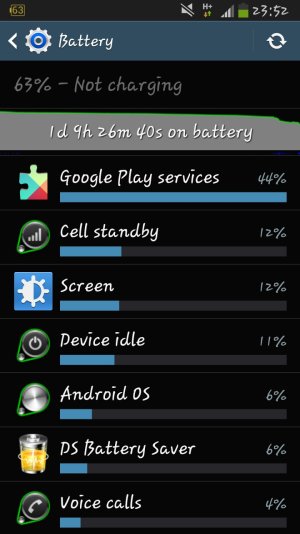

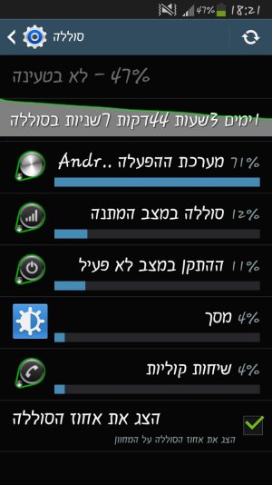

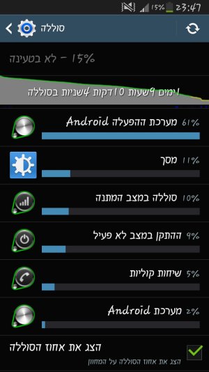

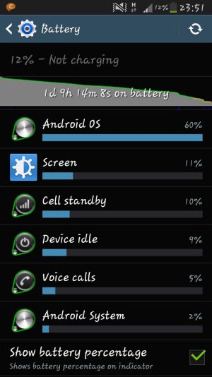

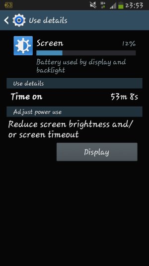

Hello Friends
I would like your help in generous
I'm trying to solve the problem of this exhausting battery
This time I solved the problem of deep sleep with an external application,
But I find that when I use the device battery runs out quickly
This means that if the screen is off then there is no depletion of the battery at all, about 1-2 percent per night
But frustration is the speed of emptying the battery used
I've included pictures your help:
1. The screen was off the whole day
2. You can see the battery discharges when the screen is turned on
3. Google services, because what appears in 44 percent of the time is very low for about 5 minutes
4. Screen time ...
962,952
6,992,268
3,164,952
