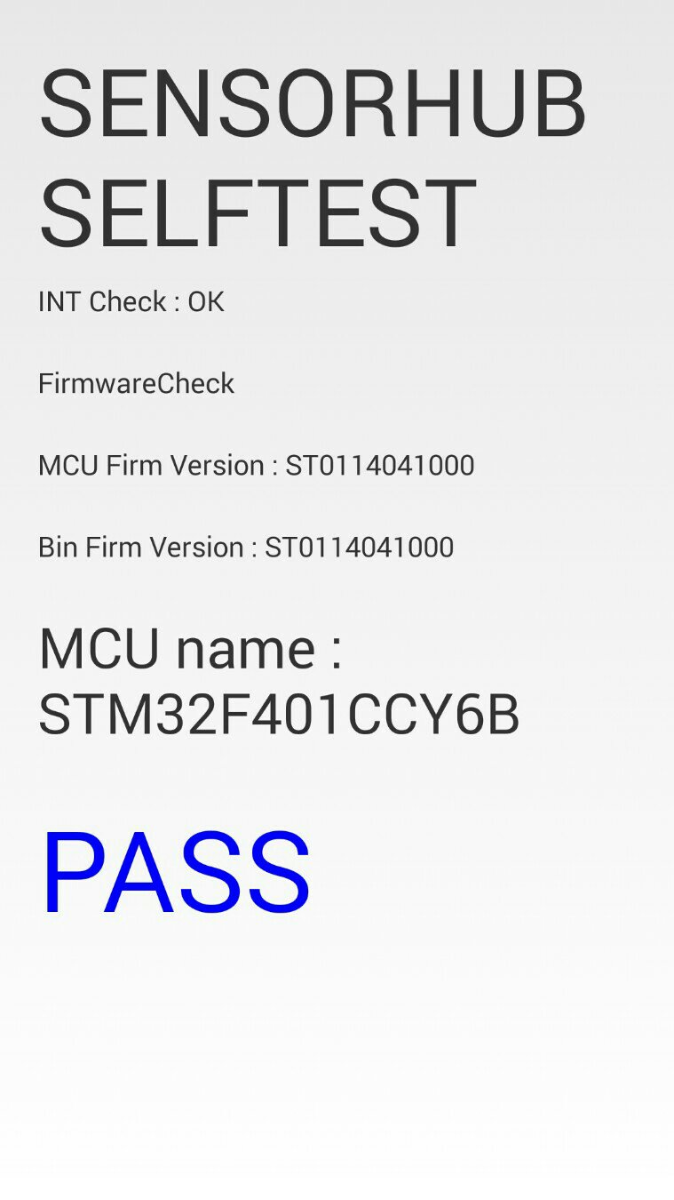

You can do tests on Note 3's that are not carrier locked by dialing *#0*#, but it won't offer a solution.
