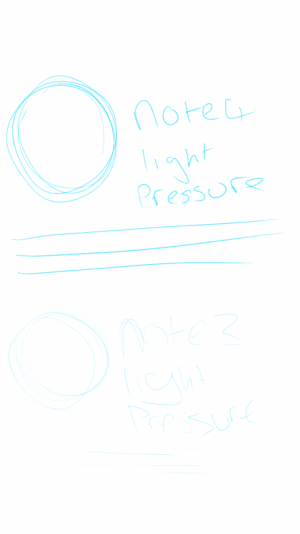

Hey guys
Just got my note 4 today and it is quite nice although as I did a lot of drawing on my note 3, I've loaded up the same apps and something is note quite right, on the note 3 I never had to play with settings and it had quite a nice light pressure sensitivity, I've set my brushes up the same on both devices and the note 4 pen just doesn't have the same light pressure
The thing is if I use the note 3 pen on the note 4 it works as it should, so i know it's not the phone but the pen, I've tried the nib from my note 3 on the 4 but no difference
Is there any way to adjust the note 4 pen?
Here is a picture from sketch book of the two pens, as you can see the note 3 pen is a lot lighter than the 4

Thanks for the reply :)
Sadly it looks like the note 4 spen does not have the same pot adjust as the older ones :(
The note 3 pen draws a nice light line (shown in my picture) on both the note 3 and note 4, and the note 4 pen perform's the same on either device :(
I guess it's something I can live with and work around, or carry around the note 3 pen :D
So the hardware is all down the pen (given the same results on both devices)

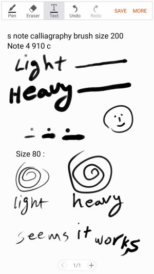

Hi dear friend . It seems that just some brushes and applications support pressure !
I tested it in my note 4 in s note with calligraphy brush and it works!
I tried to do them at the same time just with different pressure .
Take a look at it : note4pressure.jpg

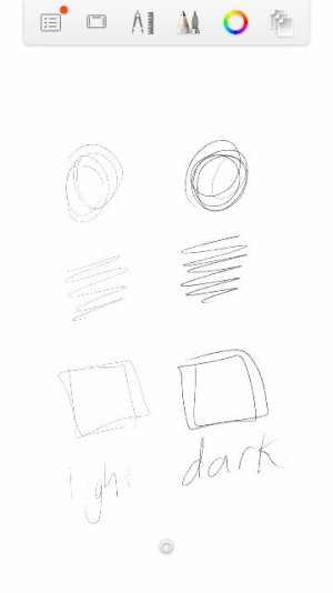

I personally use Autodesk Sketchbook and it works fine for me.
