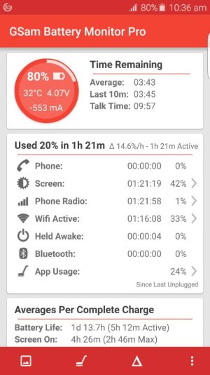

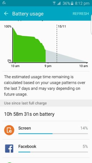

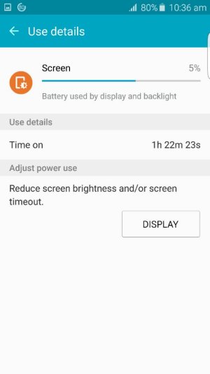

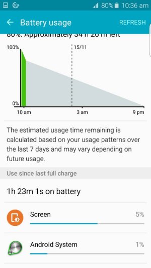

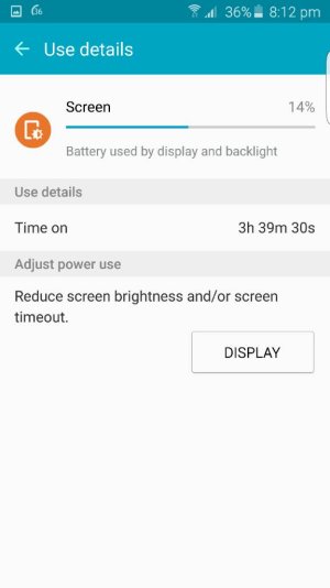

Here you go.. i took off my battery from charger and used it for like one hour i took some pictures after that...
And used my phone the rest of the day just to call and most of time it was unused..
The thing i noticed is it looses battery even if i dont use it.. i mean like in hour its looses 1% (can it be due to career)
These days im busy with exams coming close so i dont use phone much.. but when exams are over it'll be a hard time with battery drain
Also i took this screen at 8:17p.m so you guys think this is normal?
Then i will have to charge the phone twice a day
Also actually i would have used my phone only 2 and half hours active.. but im off to 34% from 100%
I also noticed my phone chargers up in 1:15min... its supposed to take 1:30right.. is it a problem?
About the screen shots : some are from after one hour of use. And rest is at 8pm odd

As everyone has pointed out, this thread you are in is for the NOTE 5, not the S6 EDGE. Regardless, your battery life is fine. 1% per hour would mean you could go 3 days with light use. Your photo at 36% remaining after that long during the day and 4 HOURS OF SCREEN TIME means you would be looking at over 6 hours use in about a 16 hour day. That's good.

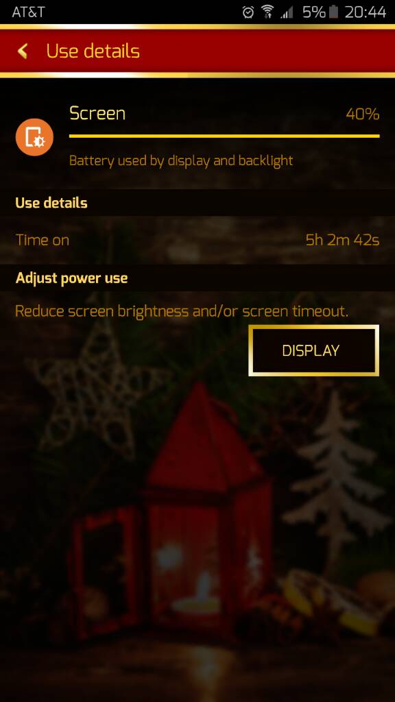

Gotta say i am very happy with my battery life on my Note 5
What do you do to get this battery life? For example on my S6 I have lots of things turned off and power save mode turned on. Are you tweaking the phone like that? Or can I expect this battery life with the note 5 without doing all that stuff?
All i got on my AT&T Note 5 is bloatware disable and Enhanced 4G LTE services turned off and location set to mobile and wifi no tweaks at all and no not rooted either since AT&T Note 5 is locked down.
Thanks! I have Sprint and I wonder if I can expect similar results. This S6 battery life is a drag.

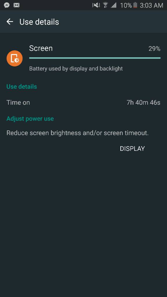

MedicD - have you done alot to get good battery out of your note 5? Looking back through this thread it doesn't seem like you were happy with it. I eeked out about 3 hours of sot time over about 16 hours up time on my S6 yesterday. Not horrible but I found I was refraining from using it. And of course running in power save, disabled a lot of stuff and blah blah blah. . . . I literally squeaked that battery life out.
My battery has sucked, but I think it's because I have bad signal everywhere in the mountains, and Verizon seems to have some issues too. Kelly on Tmob gets great battery though, so do most people.
