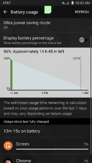

My phone battery went to sh**.. I had that GPSD showing and I turned off location. I've been testing battery for days now and tried the a dark themes, clearing cache with no help. I haven't downloaded any new apps. So, I'm getting about 4- 5 hours screen and 14 hours off the charger. This is terrible compared to before. I would get 4 hours SOT 14 hours of the battery and still have 45 percent left. I don't understand what happened.

First picture is broken.
I downloaded GSAM.
My android system shows 20.8%
kernel (android os) 1.5%
system UI 8.3%.
are these normal levels?
