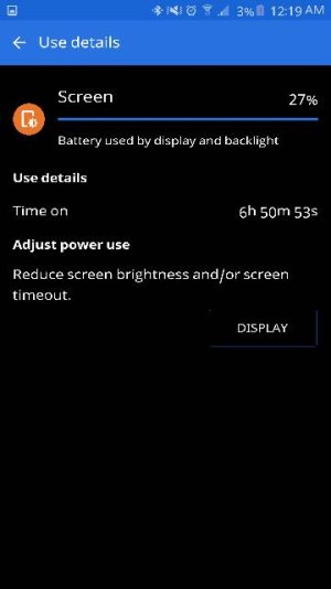

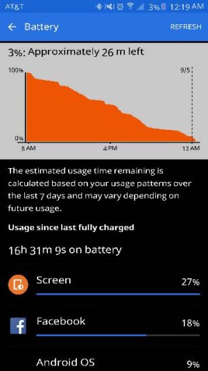

Well this is mine and I'm about to charge because I'm going out. This is with 5 hours SOT.

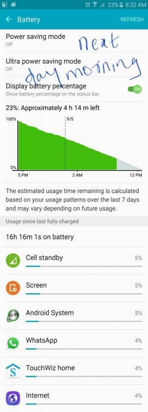

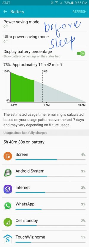

after almost a week I have confirmed to myself that only solution is turn off wifi when I'm out and about and turn on when in office and at home as I could easily charge when needed.
I experimented and bad or good signal with wifi on it decreases about 5 hours of battery life. I thought that it was my weak signal at work and home (at home I have a verizon network extender) and it made a difference in battery but not a whole lot. Main problem came down to Cell Standby going higher and higher as I left wifi on. One day I turned off my wifi all day...and I was getting similar battery life like many here that states they have good battery life and Cell Standby was way down and never rose above 3%. That's my conclusion for me...others can argue and say not so but I wanted to share my observation from my experiment (although not complete scientific). BTW...I left everything else on (GPS and BT) in both my experiment.
And I also left advance calling on for and then off with wifi on and off. Again leaving advance calling off didn't make a real difference...it's wifi on that's the culprit!
Just wanted to share my elementary experiment.
I'm on VERIZON BTW.
I am going to try with wifi off all day and see if it changes anything.

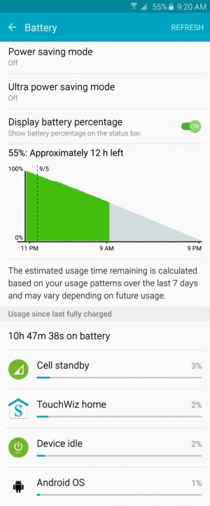

The standby time on this phone is awesome and such an upgrade from my note 4. With the same usage on a 12 hour workday, my note 5 only lost 40% while my note 4 would have lost 70%. This phone continues to surprise me.

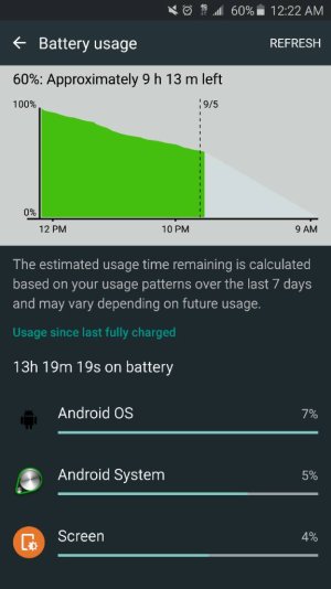

Yet another day of great SOT. 6.5 hours. I'm with AT&T, using Nova Prime. I have my email sync set for every 2 hours. I sat WiFi to turn off when phone goes to standby. I use FB and Instagram a lot and use Waze GPS for at least 1 hour each day during my commute. Obviously I've disabled the basic AT&T bloatware but that's about it.

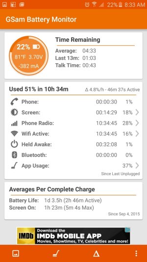

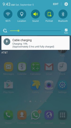

5 Hours to charge fullly
Anothoer Note 5, which discharges
Let me know if you need any thing else to diagnose better

There is nothing to diagnose. If your phones are taking more than 1.5 to 2 hours to fully charge, something is wrong with them, unless you aren't using the adaptive fast charger.
This got resolved after adjusting cables again.
But as per my earlier screen shots in over night it discharged about 40%.
I have tested with other Note 5, which discharged almost 50% in 7 to 8 even though phone is in ideal. and in both the phones have i have disabled all ATT app, Samsumg Apps, and google apps which i dont use and have not installed any apps, Except GSAM Battery Monitor
