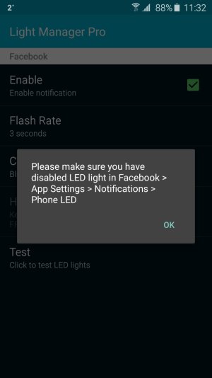

i installed light manager on my s6 and it's working without a problem, the only thing you have to do is disable the in-app led notification for the apps you enable in Light manager :)Screenshot_2016-01-11-11-32-11.jpg
