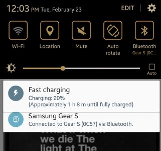

It will show fast charger connected at the bottom of the lock screen for a few seconds when you plug in the charger and it will show in the notification pull down.
