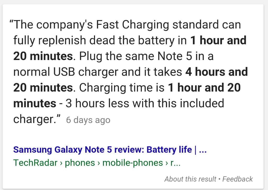

Two hours seems a little long, I charged mine last night at around 20% and it said 1 hour and 14 minutes to fully charged.
It isn't long. It takes 1.5 to 2 hours to fully charge using fast charge.
My Note 5 usually takes about 1 hr, 20 minutes when down to 5%.
My note 4 is usually about 1 hr 5 minutes
My Note Edge is usually about 1 hr 10 minutes
I have never seen the Note 5 take longer then 1 hr 30 minutes.
