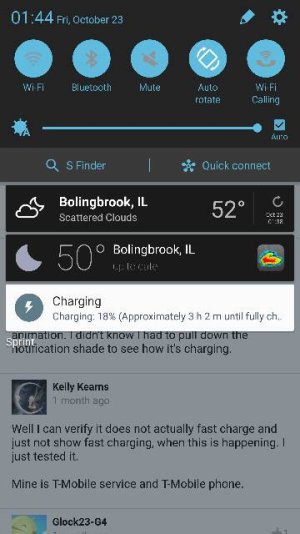

I have a Note 5 amd it is at 18% right now but it is not on fast charge. My phone just started doing this about a couple of days ago.
Im sorry I forgot to add that I'm eoth Sprint.
