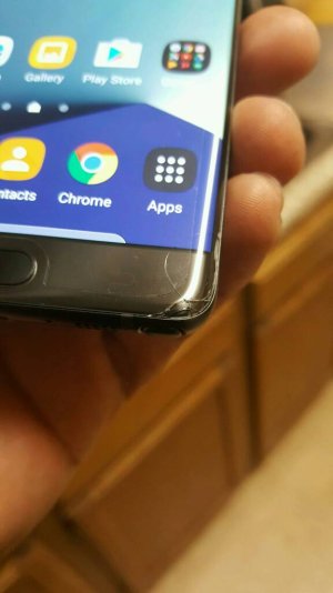

Note 7 Has A Screen Defect (phone cracked after being dropped)
Re: more fragile then my note 5
It's very brittle. Took mine out of my pocket to find the top left corner was cracked. Never dropped or suffered any kind of impact. My brother's phone slipped out of his pocket and fell between the car seat and cracked. There is a problem with this screen and i honestly believe that we will see more and more reports as the days go by.

I believe the Active , it came down to QC of assembly. With the glass on the Note 7. The edges are not protected being flush on the frame... it's curved on both sides and it's going to be the weak point. On top of that both sides are like that so possible to crack front and back. This front will just need more care than others.

Corning's new Gorilla Glass 5 is meant to survive epic smartphone drops | The Verge
"What will define the performance of the overall device on those types of corner drops is stiffness of the phone design, but also how the glass is packaged," Bayne said. Much of this is dependent on what's known as the "proudness" of the glass, which refers to how high above the phone the glass sits. "If it sits up really high, we call that a proud design. If it's protected by the bezel of the design then, it's - not proud. So if you have a device that has a proud design, that one wouldn't perform as well as one that had a different design."
"And as we go to 3D designs, the edge is more exposed ... and you have to be sensitive to that," he added.

At the 3 minutes mark mentioning friends with Note 7... "cracked while in his pocket." :confused:
And pic again shows... cracked at the corner/curve. :-\
