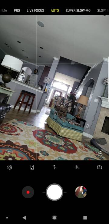

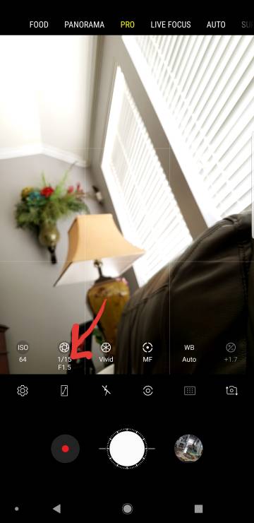

Does anyone else's device do this? All my camera modes worked fine yesterday, but today the Pro option only shows black! I'll attach screenshots of Auto then Pro.

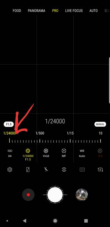

Slow the shutter speed down enough and turn up the ISO and you can get a pure white screen as the entire image would be blown out.
Excuse me. I had it turned down too far.
:-p you had the shutter speed to low. There is no mechanic shutter on these phones thus no way to “close” the shutter. The sensor itself can be turned off. Lack of mechanical shutter is one reason why cellphone cams are still a ways away from being as good as dslr’s and MILC’s.
Actually the shutter speed was too high/fast.
Blame Sammy for using 'A' in most of their prior cameras and still using an icont that's most commonly used for Aperture (guess they see it as Aperture TIME).
