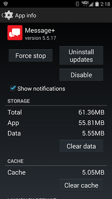

Found a solution to this issue for me. Hope it works for everybody else.
Go to Settings, Apps, Messenger+ and make sure there is a check in the Show Notifications box.

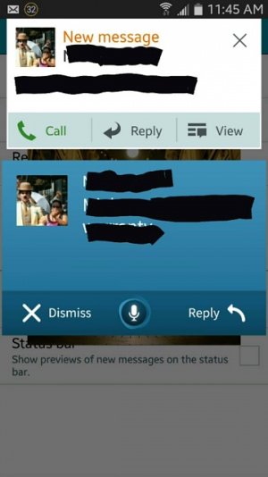

I was having the same issue, went through all the fixes, nothing worked........ however, after disabling the "pop-up window" for the stock sms messaging app, I have not have had a problem since. It's a nice feature which I would like to have as a preview, shame......
Anyone know whether this is an android issue,or a hardware fail??
