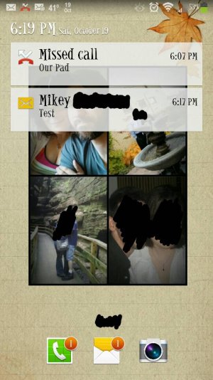

Can you please explain how to get notification on lock screen? I am using Note 3 and switch from iPhone 4S.
Palm Treo line > Blackberry line > Samsung Galaxy S line > NOW - the Samsung Galaxy Note 3 😊
I think he means if he pulls down from the top he can't open like a fb notification for example. You can open it but you then have to unlock the phone manually
