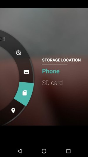

Welcome to the forums. Which camera app version do you have? This is what I have on my old X Play. You need to slide the wheel up to get that option.
"Which camera app version do you have?"
I don't know how to learn this. I bring up the Camera app, but I see no option to find the version.
" This is what I have on my old X Play. You need to slide the wheel up to get that option."
I cannot see any such SD-card icon, no matter how I spin the wheel. It is simply not there.

Strange. Try this, go to settings - apps - select Camera and you can see the version there. Also, select 'Permissions' and confirm that everything is checked. What do you see under 'Advanced'?
You can also try this, go to settings - apps - Camera - Storage - Clear data and then restart the phone.
After this take a screenshot of the camera wheel after sliding it up to see which options you get.
