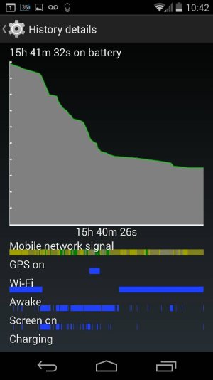

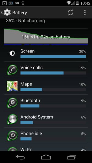

Here is my battery after today. I said that I would post the stats after a days use. I'm pretty impressed with the battery life. But what do you guys think. Again, foreign phone and OS. Just want another opinion!

Pretty good. Tap on the Screen entry on the left screen to find out how much screen on time you've had so far, and see if you're on track for 3-4 hours total (which is normal). Also, there does seem to be relatively frequent red bands in the Mobile Network Signal in the right screen, which means poor signal--that can contribute to battery drain, since the radios are straining harder to get a signal. If you're in an area that you know has bad cell signal, you could temporarily switch Airplane Mode on, which will turn off the cell radio and save battery. Airplane Mode initially turns off Wi-Fi, but you can manually turn that back on and still remain in Airplane Mode.

Welcome to Android Central! You should post your question in the MeMO Pad 8 forum: ASUS MeMO Pad 8 - Android Forums at AndroidCentral.com. This is a thread about the Nexus 5.
Also, do this: Charge up to 100%, then let it drain to 20-30% with normal usage, without charging in between. Then show us:
1. The main Settings>Battery screen.
2. The fullscreen battery graph screen (which shows Awake time and Cell Signal Strength).
3. The Screen category (to see total Screen On time).
4. The Cell Standby category, if present (to see Time Without Signal).
http://forums.androidcentral.com/am...ide-how-post-screenshots-android-central.html
