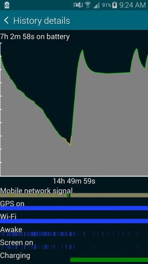

When i first got this s5 my battery would last me almost 48 hrs with pretty heavy use. Now im charging it 3 times a day and within an hour of having a full charge it falls to about 70%. The last 2 nights iv woke up to a battery thats only at 92-95% charged below is a screen of my battery graph yesterday morning. Iv got got a new phone new battery and have everything i dont use disabled. Even though i never used to have to disable anything. Anybody know why im all a sudden having this problem?
First thing I would suggest is to find out if something is trying to connect to the internet all the time.
Turn off data and wifi, and monitor the battery after a few hours. What you should see on the battery graph is a much flatter line indicating that the battery use is much lower than what you have now.

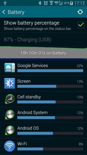

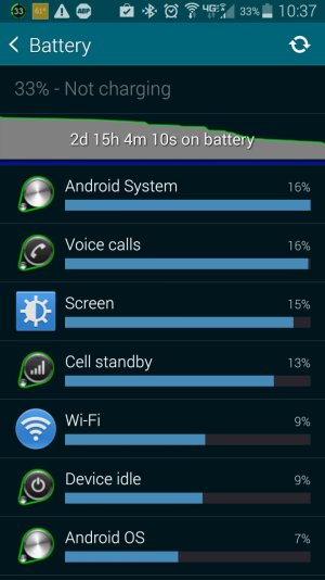

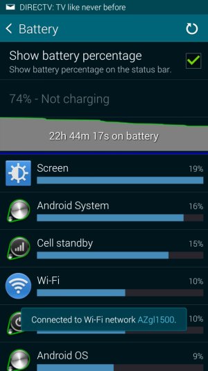

My Samsung Galaxy S, the original phone in this series is almost 4 years old and the battery will still give me almost two full days of use with MacroDroid handling the internet.
