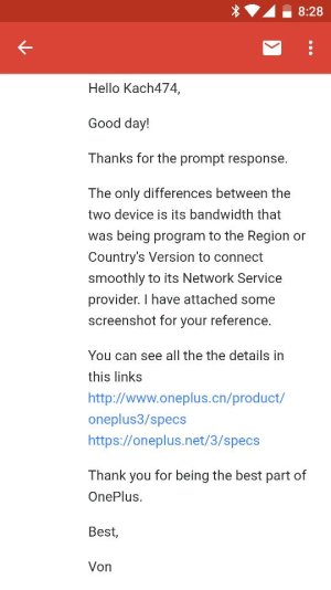

The full model number is A3000_16_161118
From what I have found the North American model and the China model have the same number. But they have different bands. I have not found out how to tell the difference between the two?
I gave the customer service rep for Oneplus my imei's. He said the imei's on my phone are in their database as the China model.

When I received my email from Oneplus stating I had the China model I asked how to tell the difference between the two of them. This was their response.
