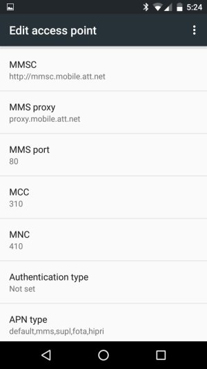

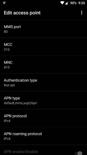

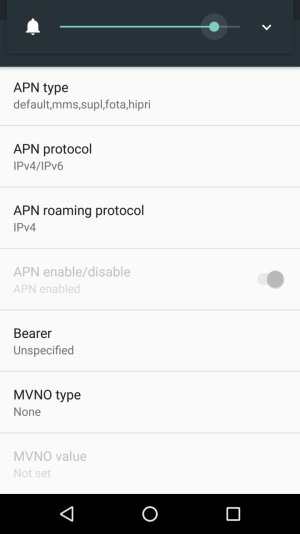

Here's the AP from my N5. I remember when I got my N5 I had to go into the ATT store and they had to modify my plan and provision my plan for LTE. Once I did that, I did a reboot of my n5 and got LTE. As a side note at that time the N5 didn't show up in there system.
