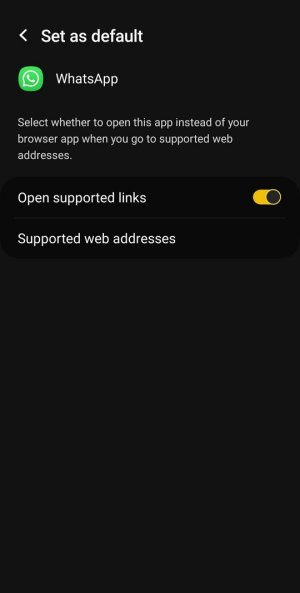

There are no other apps under the Settings>Apps>WhatsApp>Set as default> that you mentioned - see the screenshot below.
I'm using One UI version 5.1
