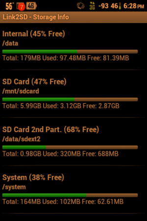

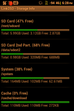

Hi everybody,
I've been having some issues, which I've seen documented in the Mirage ROM thread and elsewhere, but haven't been able to find the solution to my issue.
I have Mirage ROM on my Optimus V and installed Link2SD around the same time that was set up. I believe everything to be set up appropriately in Link2SD and with the SD card partitioning, however my system cache at /cache/download keeps filling up, causing me to be unable to install Play Store applications.
I can delete the folder contents or wipe cache through the recovery menu, however after the next reboot it will have filled back up to the point of unusability.
There is probably some simple thing that I neglected to do, but if anybody could guide me in the right direction, that would be super.
Thanks!
