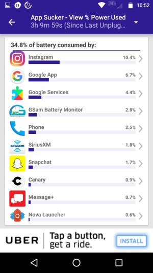

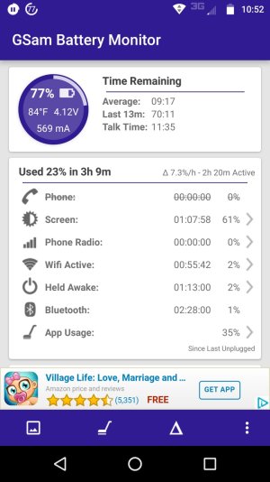

Thanks again for the help, here are a few from today, off battery for about 3 hours and at 76 percent. I did stream about 45 minutes of audio and made about hour of calls. I'll post more at end of day. Screenshot_20161004-105230.jpgScreenshot_20161004-105239.jpg

One bar of reception...Is that normal?
My first thought, too - weak signal, and 3G to boot. Weak signal will kill the battery.
Also, one hour of display on in 3 hours. That's a lot of screen on time in such a short period. (Interesting that "phone" is crossed off, but it shows up in app suckers.)
I don't use Instagram, but if there is a way to turn off background updates, I'd consider that as well. You can catch up when you actually open the app.
The fact that GSAM is high on the list suggests to me that the issue is more with poor signal than app use, though.
Couldn't agree more.
Also agree about Instagram. Unless you absolutely need to see your notifications on the app icon, I would turn off background updates.

Another app I would install is called Signal Check Lite. It will show you what your actual signal strength is. Post some screen shots. The higher the number the worse it is. Here's my story....... I'll try to keep it short.
I had a bad 4g signal for years. Mine was an average of -120 to -125. I couldn't hold a 4g signal and was forced onto WiFi or 3g.
Before I bought the Z Force I made several calls to Verizon. I refused to give up. I now have a 4g network extender. But I had to call several times and threaten to leave with several accounts.
But be careful they don't try to force you into a 3g network extender. You pay for 4g so why shouldn't you get what you pay for.
If your phone is searching for a signal that will drain your battery fast. Be sure if you go into location settings and touch the menu 3 buttons top right of the screen, scanning should pop up. Touch that and shut off wifi and Bluetooth scanning unless you need them. That will also drain your battery.
At night I shut off 4g and touch the 3 menu button and restrict background data. Calls and texts still come through. But it's my data and I don't allow apps to use it in the background unless I'm using that app.
I hope these help. From your screen shots I suspect a bad signal strength. But I could be wrong. Give it a try and see.
