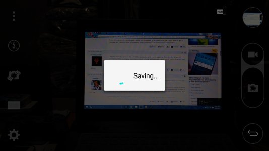

I tried replicating this, but the camera saves the photo.
That's because, like on sswitzer's unit, mine says "Saving" before the camera app quits.
I presume it's a possible bug with carrier-branded units.
