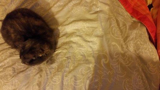

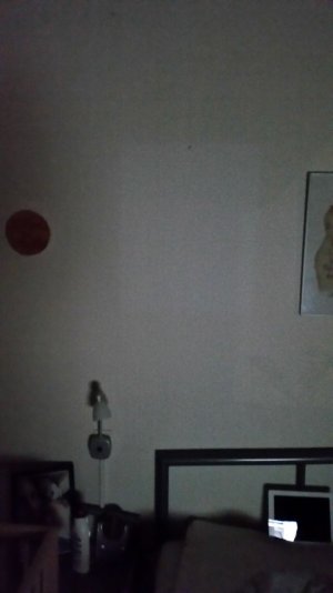

Anyone else getting this? These photos are taken with 2 different samsung galaxy s5 devices and with everything on auto
They are taken with curtains drawn in the morning, with light coming through the curtains.
Aside for this I'm very happy with the photo and video quality

I guess I'm the only one with this problem. The pinkish/red spot can also be seen in video. I have tried changing white balance and that doesn't work either

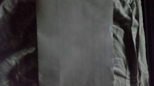

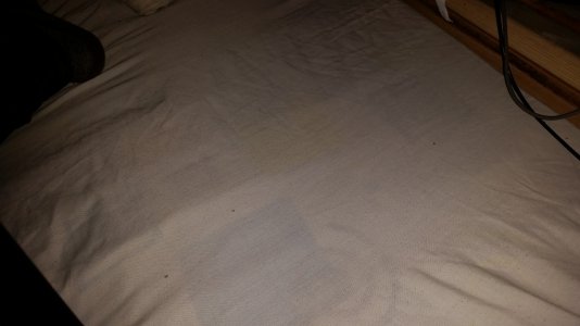

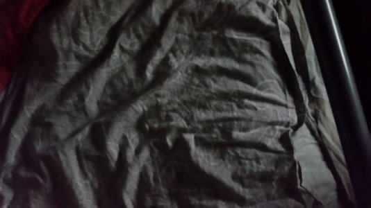

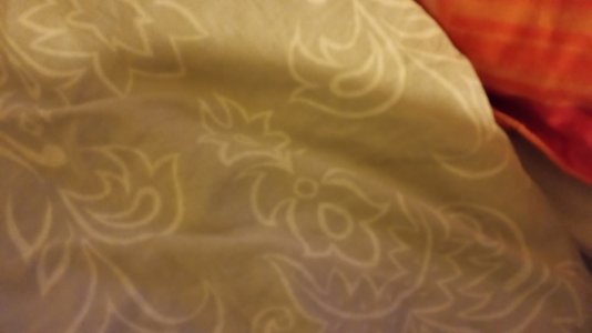

Here are some photos in similar conditions (kinda low light but not really, indoor with light coming in through curtains and an incandescent light but its not very light in here)
I can't see any pink spots on mine but not sure - I had a similar issue on a phone a long time ago except that the spot was green rather than pink. 20140419_184429.jpg
The yellow/blue blobs here are the colour of the mattress under the sheet
20140419_194017.jpg]

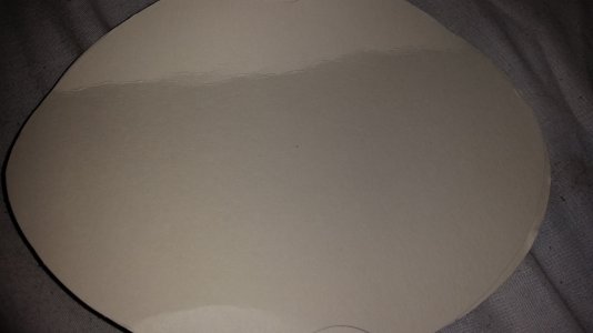

white piece of card to test again

The light look a bit different in yours. Did you use flash?

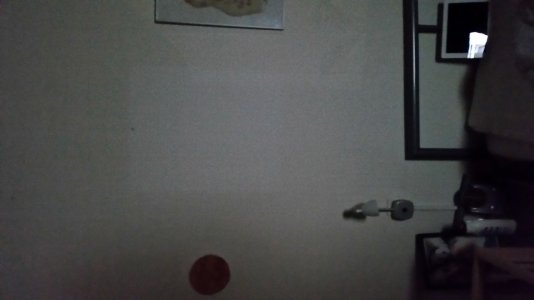

Here are some now with lights from my monitor only. Again the problem is gone

The problem actually goes away when it's really low light as seen here. These photos are taken with only light from my monitor

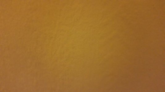

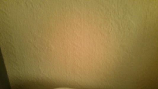

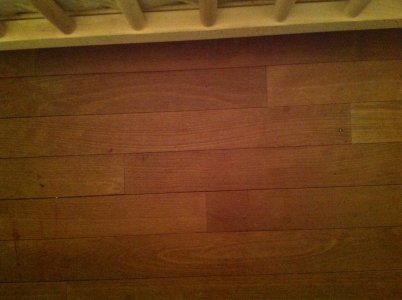

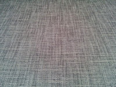

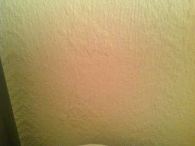

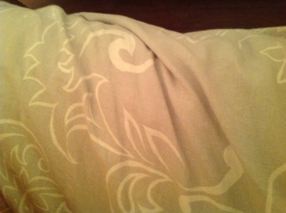

Seems like it isn't a galaxy s5 issue at all. I was able to reproduce the exact same problem with my ipad 4

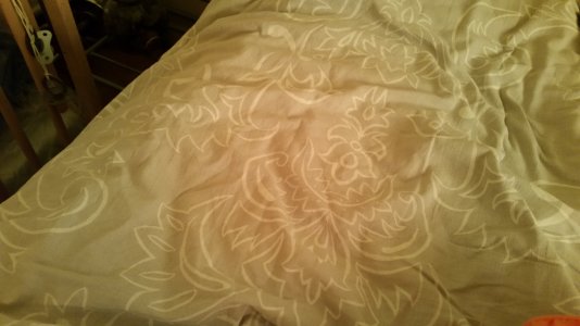

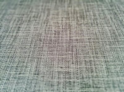

I have the same issue on my Nexus 5. I noticed it just now when trying to take close-ups of my sofa to sell it online. IMG_20140517_155208.jpg
I have the same issue on my Nexus 5. I noticed it just now when trying to take close-ups of my sofa to sell it online. View attachment 118717
