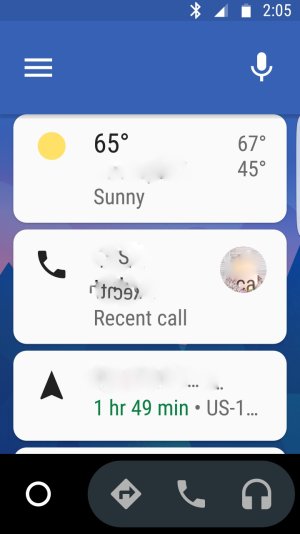

OK, disabled everything with the word car I could find. Found out I can't turn off car dock without root, so that's not possible for me. Wife had car most of the day yesterday running errands, doctor, etc. Going today to pioneer dealer and we are going to try other usb cords and see if maybe there is a magic one that might work.
Thanks for all of your help, it is appreciated. I will keep you posted if any progress.

Radio smartphone setting to "others"
Plug phone into USB 2.
Phone will download android auto automatically..and start the Android Auto.
SUCCESS!!!!
Wife's OEM cable with developer options turned on, usb debugging on, buffer size for logging set to 16 MB (Don't know if this did anything, but someone on another thread suggested it so I went with it), usb configuration set to mtp and we are rocking and rolling!
Thanks to everyone who tried to help. This truely is a great community.
SUCCESS!!!!
