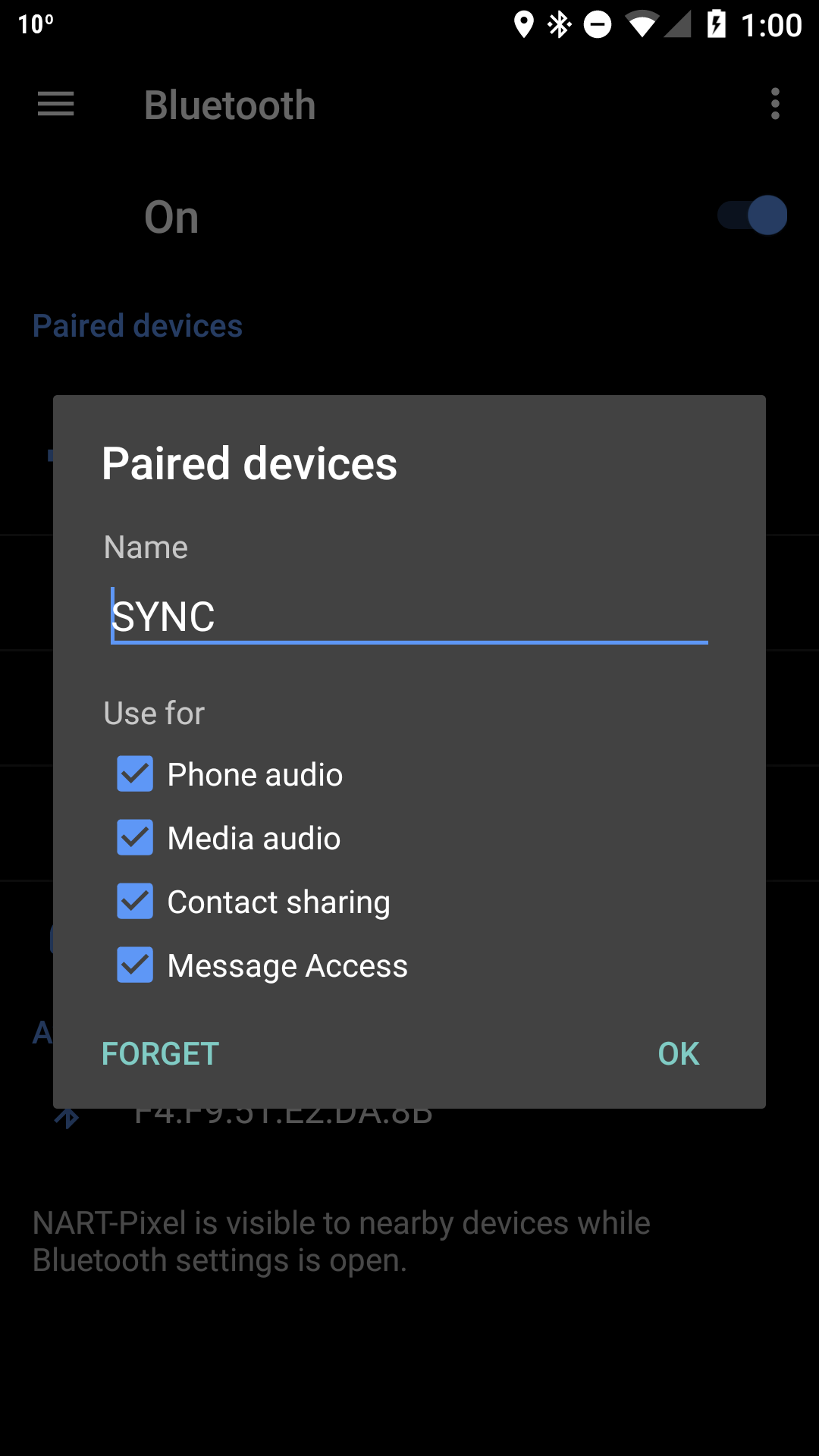

So for the first couple days my new pixel connected to my car flawlessly, but I just saw mention of 7.1. I updated to 7.1 and now for some reason I always have to turn bluetooth on, on my phone. so I'm not sure if I can do something to just have bluetooth on, on the phone all the time. And, I'm going to try to pair it with my ford sync AGAIN (3rd time) because since 7.1, I can't get the phone to acknowledge media, just phone - which drives me nuts because I love being able to play my google play - playlists while I drive. If anyone has tips on this out there, I'd really appreciate it. I love this damn phone so far (only had a week) but the bluetooth issues are now slowly driving me insane. :confused:

Should be pretty straight forward. Do you have the Media Audio option checked in Bluetooth option for the Ford?
