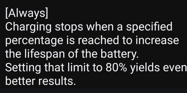

Here's what my battery care page says when set to always on, limiting it to 80%.

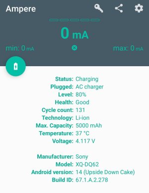

And once I hit 80%, charging stops just like it would when it hits 100%. I can see that on Ampere. At this point, the charge rate drops to zero. Ampere sees that it's plugged in, but the charge current goes to nothing and stays there from then. Occasionally it'll drop to 79%, but that's it.
Yep, this is what I figured was going on.
It's still discharging/charging, steadily, just not charging it to 100%, so you're cycling 79-80-79-80... instead of 99-100-99-100...
That is not what it's doing. If that were the case, then it would show up as a positive charging current. Charging current is zero, and the occasional drop to 79% is just that, occasional. When it does happen, it never goes back up to 80% if it is still plugged in. If I unplug and plug back in, then it may do so, but I've never tested that idea. When I unplug, I leave it unplugged until around 30% just so I'm not also overly cycling the USB port and risking wearing out the connection.

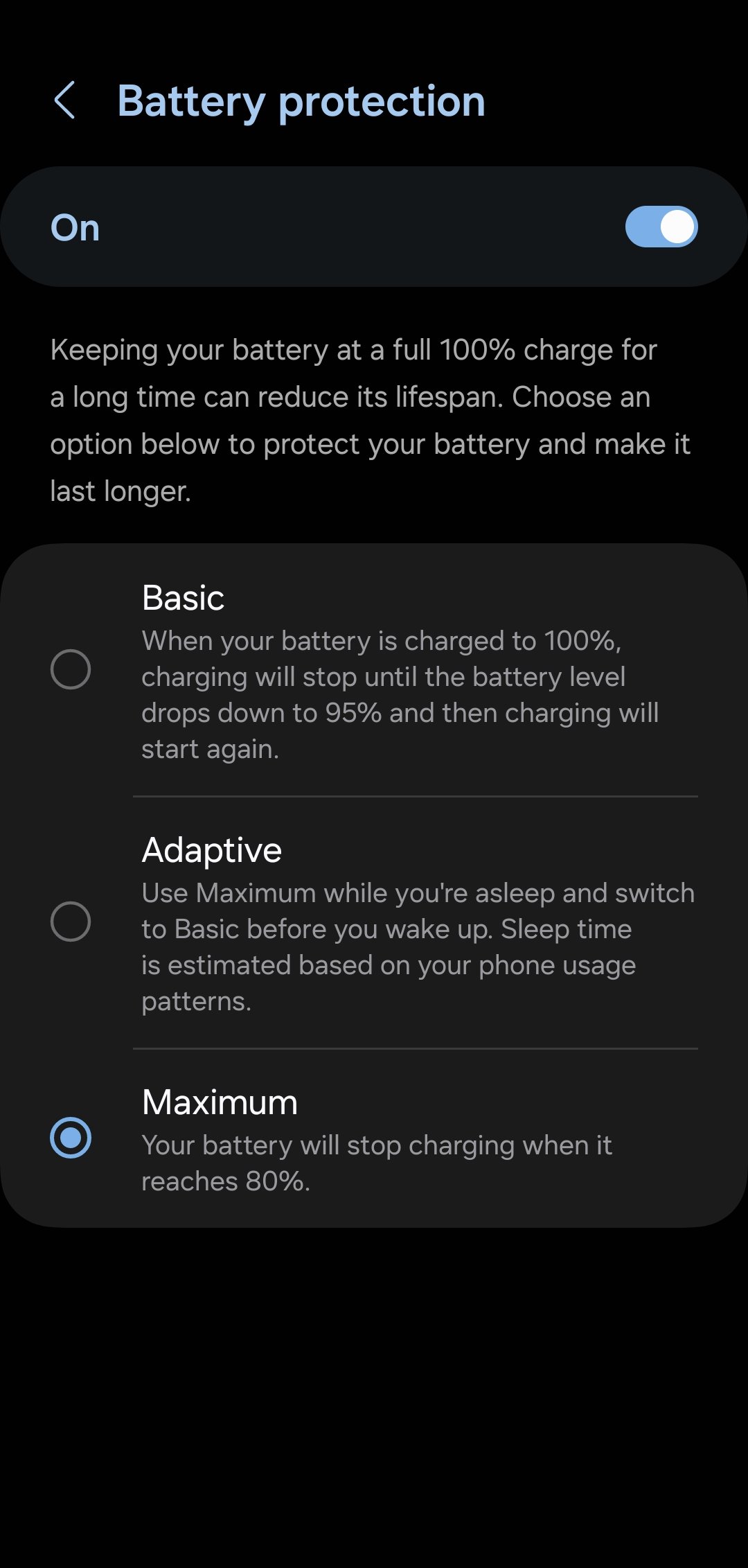

I'm not a fan of trickle charging which is an option on my Samsung especially on lithium ion battery, I have it cut power once it reaches 80% if you have it cut off at 95% like my iPhone that's ok also just going degrade little faster then 80% cutoff
You can see the options below for my s24u
