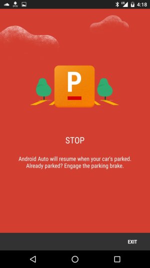

Just FYI this is still an issue. I have the latest firmware (1.04) on my 8200nex and a Pixel XL with current updates and get the exact same red screen. Followed Pioneers workaround by turning off AVICSync etc.. tried Pioneers suggested cables, ordered 3 on the list from Amazon, oh well needed some USB-C cables anyway. Worked great with Apple car play. Just hate Apple telling me what to do so went back to Android. I see that was a mistake. From what I've read, Android Auto is a complete mess.

Mine only works in USB2 slot. Try changing your cord, just remember that firmware can only be updated in USB1.
As for the e brake, the green cable must be attached to you e-brake sensor to ground it out when e-brake engaged. You can also ground it to the black ground wire on your wiring harness.
