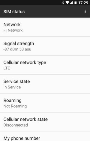

Go to the phone app and type in *3001#12345#* from the phone dialer. From there the dots turn into the phone's dBM.

-97 is better than -110 (note that these numbers are negative. a larger number, in this case -97, is better). Your mileage may vary, but between -95 and -100 is about where calls tend to start dropping for me; over -105, I can almost guarantee my call will drop. I'm lucky to be able to make a call at -102 dBm or worse.
