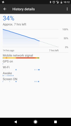

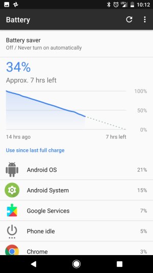

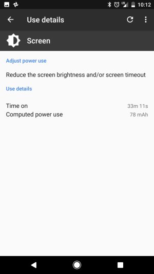

Hi,
Some background - in the past I've had a Nexus 5 which always had terrible battery life despite being replaced a few times so I assumed it was normal - it seemed to drain whether I was using it or not. I then switched to an iPhone 6, which always had comparatively awesome battery life and if I didn't use it would hardly use anything and would last for days. Same with my work iPhone SE - if I don't use it then I only charge it every few days.
I've now switched back to a Pixel XL. Fantastic phone and glad to be back on android, but seems to exhibit the exact same battery issue as the Nexus 5 - what gives? I barely used the phone last night and didn't charge it overnight, and now it's mostly drained? Here's the screens:
Screenshot_20161023-101256.jpgScreenshot_20161023-101250.jpgScreenshot_20161023-101241.jpg
The only thing I can see is that the network quality looks consistently terrible, which doesn't make sense as this is all in a city (Calgary, Canada) and I have no issues with call quality/speed. The Nexus 5 looked the same. Is there something I'm missing? Carrier is Koodo on all these phones.
If anyone has any idea what is wrong here the help would be much appreciated. Thanks!

Welcome to Android Central! I moved this from General Help to the Pixel forum, since I thought it would be most useful for other Pixel users to chime in. However, I will note that my 6P has also been exhibiting increased Android System/OS battery percentage use, with similar usage graphs, so I wonder if there might be an issue with Nougat.

To eliminate the network quality, turn data off overnight and see what it looks like.
My next test would be to leave data off for a night and then turn on wifi to see what that does to the battery.
Re: What's wrong with my battery/network strength?
Thanks - that probably should have been my first action, but I went straight into disabling LTE instead and that seems to have calmed the background draining and made my battery behave like it should. This is last night, with me being unable to sleep, 2h 43m SOT:
Of course though, I'd like to leave LTE on, and I shouldn't have to do this! Is there a possible network issue with my carrier and LTE?

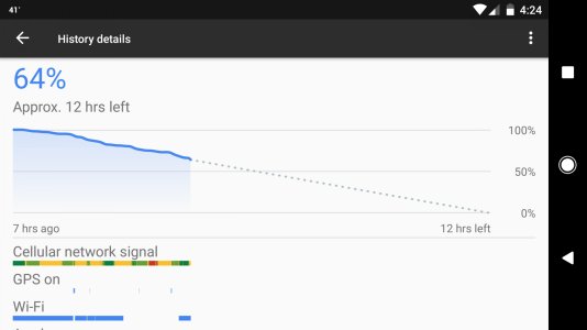

I have the Nexus 5X and just received a Pixel XL. I'm using AT&T as my network.
I noticed that my Pixel XL has an extremely weak cellular signal. At my house it shows -115dBm while my Nexus 5X has -95dBm. They talked up the Pixel and it's three antennas and the phone having great signal strength but mine is horrible. I was wondering if anyone else who went from a 5X to a Pixel have similar strength issues or if my phone is defective.
I have since received another Google Pixel XL and the signal strength is just as bad. I have tried three different SIM cards and even went to the AT&T store to get a brand new SIM card and the signal strength is still awful. The weak signal strength also killed the battery. My Nexus 5X always has green signal strength. Look at how bad the Pixel XL is.
