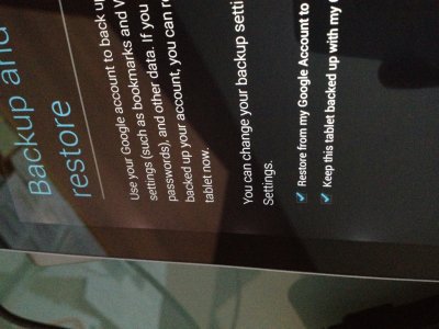

"there are four lights..."
This is in automatic brightness mode when the screen produces low brightness. They are unnoticeable in high brightness.

I think I have BLB but to see it I actually have to turn the Brightness down and display anything with white or colors. Then it shows up as four bright lights shining onto the screen. I might swap this tablet out tomorrow as it also has really bad screen lift (the glass is very clearly above the bezel down the entire length of the left side).
