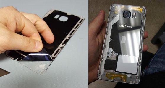

So I found this on XDA. (Please check your phone for this build quality issue. See picture and details. - Post #26)
Evidently, what gives our phones 'color' is a piece of cellophane that is inserted into the phone's enclosure. It could be that the cellophane doesn't cover every nook and cranny (as it might have on previous models) and so it gives the illusion of poor finish. If it isn't already obvious, they've also reported that water resistance isn't compromised.
Interestingly enough, you can make your phone transparent if you're so inclined.
