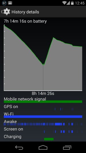

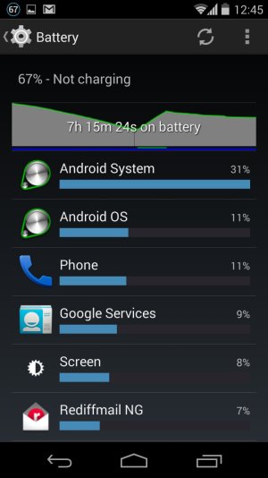

I have the same Battery drain issue after a normal use till 4 months since purchase. Few days back suddenly my phone got the battery drain issue. Till date it use to drain 3 - 4 % over night ( 8 hrs ) but now after a 100% charge before sleep the phone is dead in the morning. Also have notice the phone gets really hot near the camera area ( I assume that's where the CPU is ). Below are screenshots of 2 different days, where in Android System is the once that consumes the most battery all the time and sitting there on top of the list always.

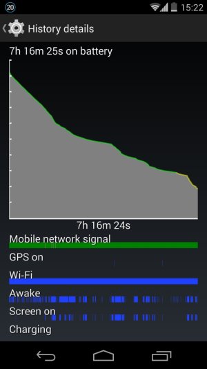

another day

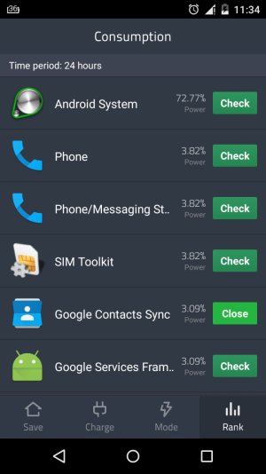

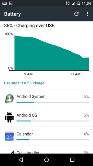

I'm having a similar issue. I just factory-reset my phone on Saturday night (2 nights ago) and it was fine. Without installing any new apps though, I get a massive battery drain attributable to "Android System". From about 8:30am when I unplugged the phone at 100%, I'm now down to 36% in not even 2 hours!! The phone was in my backpack the whole time, so I wasn't even using it.
I notice that turning off the location, bluetooth, or wifi don't do anything. Turning off the mobile data seems to fix the issue, but not everywhere will have WiFi and I can't go around all day with my data off. Any idea what's causing this?
