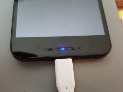

Well, it's my unlucky day. Nexus 5X just arrived. Took it out, set it up and then tossed it on the charger. But every time I charge it (yes, included cable + brick), the phone crashes after a minute or so into some crazy screen I haven't seen before — "DemiGod Crash Handler" and asking if I want to do a RAM dump. Think it's some sort of LG thing? Haven't seen it on any Android phone I've tinkered with. The phone's LED also goes solid blue.
I'm able to reboot out of it just fine, but when i charge again, it crashes out. Gonna chat with Google Support right now.

Does it charge if you're sitting on that screen?

Yup it does charge. But only way to get it to reboot out back to the OS is to unplug.
