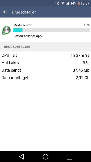

I cannot stop thinking that the below screenshot is (at least part of) the key. Why you ask. Well, the mediaserver process is no longer shown in my battery overview, which makes me nervous of what will happen next time I use an app that triggers the use of the "mediaserver".
I am not sure which apps use Mediaserver, but I will look into this and try to see if I can somehow trigger it and then confirm whether my data drainage problems are actually fixed.

The problem is back. Good news however. I can replicate the data drainage.
I started the app Tv2Play, which is a video streaming app for a Danish broadcaster and streamed shortly. I then noticed the following
1) the mediaserver process came alive in the battery section
2) the Andriod OS line in Mobile Data started showing a continously increasing data use (around 5 MB / second)
3) The Tv2Play app reported 0,1 MB use
I tried shifting between Mobile data and Wifi, but this did not stop the data use. It just shifted the stats between mobile and WIFI.
I realised that the app was still running in the background and hence might be buffering. I closed the app by swiping right in the task manager and to my surprise the data drain continued!!!! I then restarted my phone and the drain was gone.
Update:
The data drain seems to be related to poor error handling in the app. More specifically the broadcaster offers several channels in the app and sometimes when I try to open a channel an error will occur. I just succesfully launched the app and a channel and then left the app in the multitasking background. Result, no data use! This leads me to conclude that as soon as a channel fails to launch the drain starts in the background.
